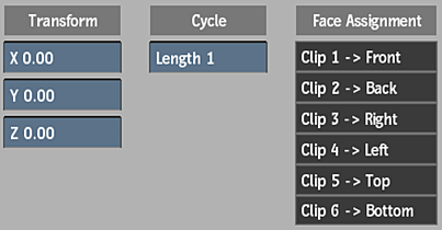

Transform Settings
These Transform settings apply to Cylindrical, Angular, Spheric, and Cubic, (Horizontal or Vertical) input formats.
Transform X Position field
Displays the horizontal value of the image.
Transform Y Position field
Displays the vertical value of the image.
Transform Z Position field
Displays the depth value of the image.
In addition to the common transform settings, a Cubic (Spliced Faces) input format also contains the following settings:
Sequence Length field
When creating a cubic map from spliced images, indicate how frequently images change in the sequence. Each change in the sequence gets mapped to a different face of the cube.
Face Assignments fields
These locked fields display the order that the face assignment follows when creating the cubic map.

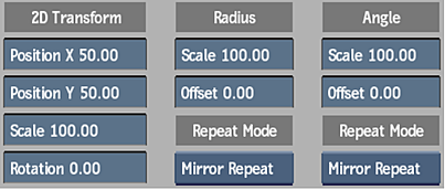

X Position field
Displays the horizontal position of the output image.
Y Position field
Displays the vertical position of the output image.
Scale field
Displays the scale of the output image.
Rotation field
Displays the rotation of the output image.
Repeat Mode box
Select an option to fill the empty portions of the frame.
Radius Scale field
Displays the scale of the radius for a cartesian to polar conversion.
Radius Offset field
Displays the offset of the radius for a cartesian to polar conversion.
Angle Scale field
Displays the scale of the angle for a cartesian to polar conversion.
Angle Offset field
Displays the offset of the Angle Scale for a cartesian to polar conversion.
Angular Repeat Mode box
