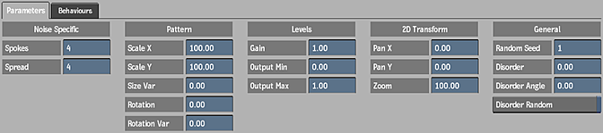

Example of Noise parameters

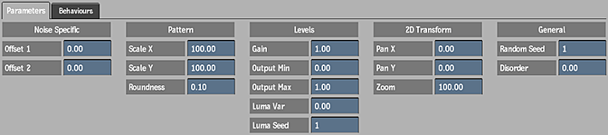

Example of Splatter parameters

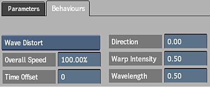

Use the settings in the Behaviours tab to apply preset motion to your pattern, and to help you quickly animate your patterns. For example, you can choose a Flow behaviour and animate your pattern to resemble a flag waving.
The behaviours are divided into a number of categories, each with their own settings.

Wave Distort
Directional warping effect that deforms the pattern with different wavelength warps.
You can adjust the playback rate and timing of your chosen behaviour animation by using the Overall Speed and Time Offset settings (available for all behaviours).

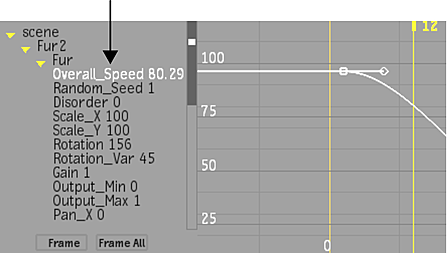

You can also adjust the Overall Speed in the Animation editor.
