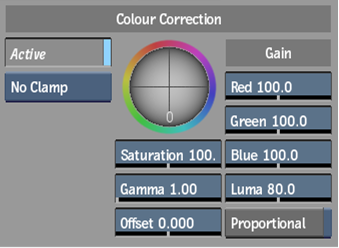

Colour Correction Settings
Activate button
Enable to activate the colour correction settings.
Clamping box
Select a clamping option.
Gain Trackball
Adjusts the gain of the input.
Saturation field
Displays level of colour purity in the image. Editable.
Gamma field
Displays the gamma level. Editable.
Offset field
Displays a value that modifies all of the colour parameters. Editable.
Red Gain field
Set the percentage of colour values in the red channel. Editable.
Green Gain field
Set the percentage of colour values in the green channel. Editable.
Blue Gain field
Set the percentage of colour values in the blue channel. Editable.
Luma Gain field
Set the percentage of luma gain value to display. Editable.
Proportional button
Enable to adjust the gain of the colour values proportionally.
