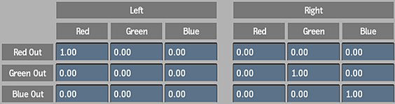

Left and Right Custom Gain Factor Fields
Displays the gain factor in the colour channel for the left eye and right eye. Enabled when Custom is selected in the Method box.

Red in Red Output field
Displays the red gain factor in the red channel for the Left eye.
Green in Red Output field
Displays the green gain factor in the red channel for the Left eye.
Blue in Red Output field
Displays the blue gain factor in the red channel for the Left eye.
Red in Green Output field
Displays the red gain factor in the green channel for the Left eye.
Green in Green Output field
Displays the green gain factor in the green channel for the Left eye.
Blue in Green Output field
Displays the blue gain factor in the green channel for the Left eye.
Red in Blue Output field
Displays the red gain factor in the blue channel for the Left eye.
Green in Blue Output field
Displays the green gain factor in the blue channel for the Left eye.
Blue in Blue Output field
Displays the blue gain factor in the blue channel for the Left eye.
Displays the red gain factor in the red channel for the Right eye.
Displays the green gain factor in the red channel for the Right eye.
Displays the blue gain factor in the red channel for the Right eye.
Displays the red gain factor in the green channel for the Right eye.
Displays the green gain factor in the green channel for the Right eye.
Displays the blue gain factor in the green channel for the Right eye.
Displays the red gain factor in the blue channel for the Right eye.
Displays the green gain factor in the blue channel for the Right eye.
Displays the blue gain factor in the blue channel for the Right eye.
