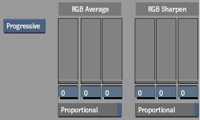

Degrain Menu Settings
General Settings
Render Method box
Select whether you are removing grain from progressive or interlaced media.
Red Average slider
Displays the amount of blur applied to the red channel.
Red Average field
Green Average slider
Displays the amount of blur applied to the green channel.
Green Average field
Blue Average slider
Displays the amount of blur applied to the blue channel.
Blue Average field
Proportional RGB Average button
Enable to blur RGB channels proportionally.
Red Sharpen slider
Displays the amount of sharpness applied to the red channel.
Red Sharpen field
Green Sharpen slider
Displays the amount of sharpness applied to the green channel.
Green Sharpen field
Blue Sharpen slider
Displays the amount of sharpness applied to the blue channel.
Blue Sharpen field
Proportional RGB Sharpen button
Enable to sharpen RGB channels proportionally.
