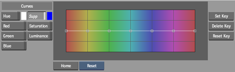

Colour Curves Menu Settings
General Settings
Curve Channel
Select the colour curve for a specific channel. Only one Curves button can be enabled at a time. Each Curves button is active when you modify its curve in the graph.
Hue colour
Set the colour to shift toward when the curve is modified. Click to open the Colour Picker.
Suppression colour
Set the colour to suppress in the clip. Click to open the Colour Picker.
Home button
Reset the position and zoom of the curves canvas.
Reset box
Reset the selected or all curves in the curves canvas.
Set Key
Set a keyframe at the selected frame.
Delete Key
Delete the selected keyframe.
Reset Key
Reset the curve at the selected frame but keep the keyframe for the default state.
