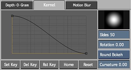

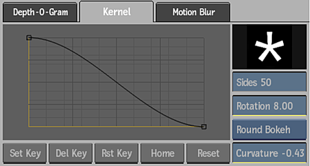

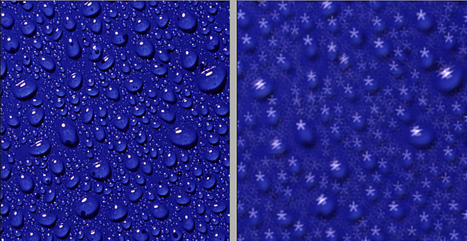

Changing the Blur Pattern
Use the Kernal tab to edit the blur kernel pattern.
The kernel is the basic blur shape. The shape of the kernel is determined by its number of sides, its rotation, and the shape of its S-curve. This curve represents the shape of the pattern, from its centre to the outside. The default S-curve defines the softness of the blur. You can change the curve by manipulating the two points that define the curve, or you can add points to the curve. Use the Tools box to add and delete points on the curve.
Sides field
Displays the number of sides in the kernel shape. Editable, if kernel information is not attached to the node.
Rotation field
Displays the angle of rotation to apply to motion vectors. Motion is rotated counterclockwise.
Bokeh Type box
Select whether to use a round or angle bokeh curve to define the kernel shape.
Curvature field
Displays the amount of curvature applied to a round bokeh kernel shape.
You can define the blur shape using external kernel information by attaching an input to the Kernel tab. The input can be a different resolution than the other node inputs.
External blur information is not editable. Like the default blur shape selections, the shape determines the influence of the kernel’s pixels on each pixel in the front input.

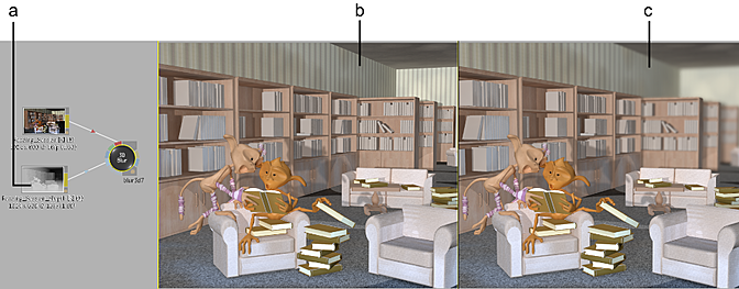

Simulating a Depth of Field Effect
Depth blur effects control the amount of blur based on a depth of field matte. Depth blur settings are displayed in the Depth-O-Gram tab.
A depth of field map (Z-depth map) can be connected to the node. Black portions of the map are in focus. White portions display the highest level of blur. Note that a Z-depth map imported from another application may use the opposite convention and may need to be inverted.
(a) Z-depth map (b) Front View (c) Blurred portion in Result View
Image courtesy of Jean-Marc Belloncik
Depth Map settings can be used to invert colour values in the Z-depth map for reuse with the 3D Blur node.

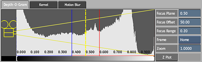

Use the Depth-O-Gram settings to refine focus values.
Focus Plane field
Displays the distance of your focus point, which is the point at which there is no blur on the image.
Focus Offset field
Displays the distance between the focus plane and the near offset represented as a percentage of the total offset range. Select 50% to make the near and far offsets equidistant from the focus point.
Focus Range field
Displays the distance the near and far offset. Editble.
Frame option box
Select how you want to frame the histogram.
Zoom field
Displays a vertical zoom value for the histogram to display. You can zoom horizontally by pressing Ctrl+spacebar and dragging left or right in the histogram. To pan horizontally, click spacebar and drag left or right in the histogram.
Z Plot button
Click to activate the pick cursor. Use to select a pixel in the image to display its depth.
Z Plot Colour pot
Displays the colour that indicates the plane on which the plotted value is located.

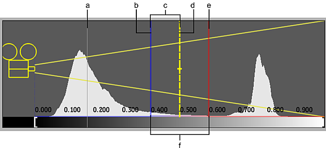

Modifying Depth of Field Gesturally
Depth blur effects can be modified gesturally by dragging the focus, near offset, and far offset planes in the graphic representation of the depth of field. As you drag these elements, the planes are also displayed in the Result view as a preview of the areas that will be in focus. Use the depth control fields to change the gamma and gain, and to change the focus range while keeping the focus plane constant. These parameters are updated in the depth of field display automatically.
(a) Plot Value Plane (b) Near Focus Offset Plane (c) Focus Offset (d) Focus Plane (e) Far Focus Offset Plane (f) Focus Range

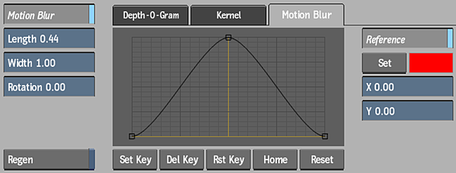

Simulating a Motion Blur Effect
The motion blur simulates the blur created by a fast-moving object or camera. A blur effect can be created with front clip input and a clip with forward motion data input into the Forward Flow tab.
Use the Motion Blur Profile to define the opacity of the blur. The opacity increases at the top of the curve. By default, the blur is more transparent further away from the pixel. The midpoint represents the opacity of the blur at the position of the pixel.
Motion Blur button
Enable to activate the motion blur controls and apply the effect to the image.
Length field
Displays the amplitude of the motion blur.
Width field
Displays the width of the blur.
Rotation field
Reference button
Enable to activate the reference controls and apply the effect to motion blur.
Set button
Enable to apply the motion blur to objects that do not have the same relative motion as the selected pixel. Enabled if the X or Y field is edited.
Set Reference colour pot
Displays the colour of the crosshair that marks the reference point in the image window.
X field
Displays the horizontal position of the pixel to use as a reference point at the selected frame. A reference point can be selected directly in the frame using the cursor.
X field
Displays the vertical position of the pixel to use as a reference point at the selected frame. A reference point can be selected directly in the frame using the cursor.
