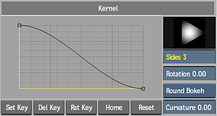

Kernel Settings (Defocus Only)
The kernel is the defocus blur shape. The shape of the kernel is determined by its number of sides, its rotation, and the shape of its S-curve. This curve represents the shape of the pattern, from its centre to the outside. The default S-curve defines the softness of the blur. You can change the curve by manipulating the two points that define the curve, or you can add points to the curve. Use the Tools box to add and delete points on the curve.
Sides field
Displays the number of sides in the kernel shape. Editable, if kernel information is not attached to the node.
Rotation field
Displays the angle of rotation of the kernel shape. Editable, if kernel information is not attached to the node.
Bokeh Type box
Select whether to use a round or angle bokeh curve to define the kernel shape.
Curvature field
Displays the amount of curvature applied to a round bokeh kernel shape.
