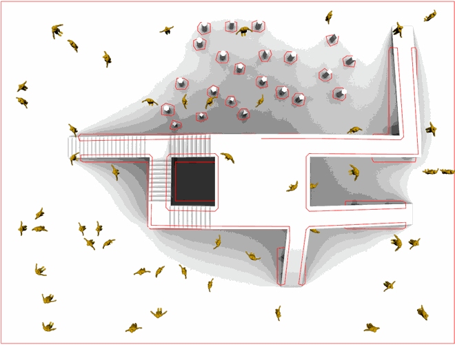

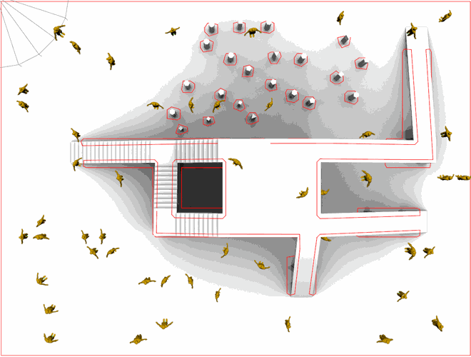

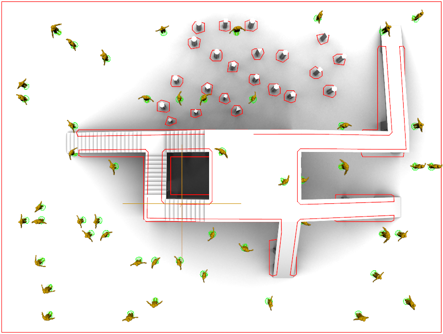

Here is how our scratch scene looks like with nothing else than an environment and a population (Entity Type, Population Tool and a NavMesh. Please see the Quick Start Tutorial if needed):
Our environment with stairs, slopes and a kind of cylinders forest, populated with characters (in orange)

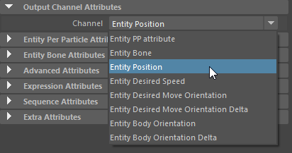

4. Configure the Output Channel to output the Entity Position
Output the entity position

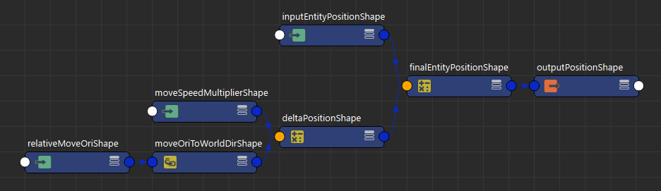

Here is what the graph of channel operators built in the following steps looks like in the Node editor:
Graph of channel operators that simply moves entities in front of them
7. Select the outputPosition node and add a previous ChOpOperation
This stage will add the entity position with the delta position to give the final entity position, rename it into "finalEntityPosition" Let the operator configured to addition (+)
8. Select the finalEntityPosition node and add a previous ChOpInput
This stage will input the current entity position into the graph, rename it into "inputEntityPosition" Configure the Expression to use the Channel "this.position"
9. Select the finalEntityPosition node again, and add another previous ChOpOperation
This stage will compute the delta position to add, rename it into "deltaPosition" Configure the operator to a multiplication (x)
10. Select the "deltaPosition" node, and add a previous ChOpConverter
This stage will convert the current entity orientation (angle in °) into a world direction (vector3), rename it into "moveOriToWorldDir" Configure the convert mode to a Body Angle To World Direction
11. Select the "moveOriToWorldDir" node, and add a previous ChOpInput
This stage will input the local delta orientation in which moving the entity, rename it into "relativeMoveOri" Configure the Expression to "0" to move the entity in front of them, or try different values to move them side or backward
10. Select the "deltaPosition" node again, and add a previous ChOpInput
This stage will set the speed at which moving the entity, rename it into "moveSpeedMultiplier" Configure the Expression to "0.03", or try different values to change the speed of the entity

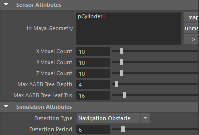

1. Create a Maya cylinder polygon, and set its radius to the distance at which you want your entities to be aware of obstacles (let's say 5 Maya units)
2. Select the cylinder and create a Sensor Locator by clicking on the  icon in the Golaem Shelf
This creates a Sensor Locator that allows entities to perceive the obstacles in the simulation. Obstacles can be either entities, or navigation obstacles (NavMesh file loaded in the Terrain locator).
Select the cylinder again, and create another Sensor Locator. One will be configured to detect entities while the other will be configured to detect navigation obstacles (see Detection Type attribute):
Sensor Locators to detect entities and navigation obstacles

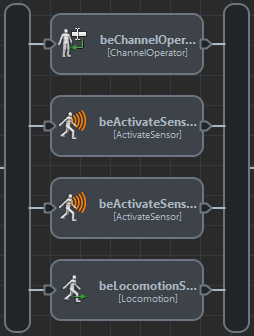

3. Sensor Locator needs to be activated on the entities. This is done by adding an Activate Sensor Behavior for each sensor:
Activate Sensor behaviors in parallel with the Channel Operator
Configure one of the Activate Sensor behaviors to activate the first sensor, and the other to activate the second sensor.

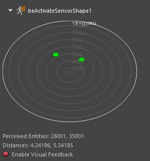

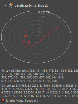

If you run the simulation at this point and select an entity, you should be able to see both the sensors in action in the Visual Feedback:
Two sensors in action in the Visual Feedback, displaying perceived entities (left) and navigation obstacles (right)

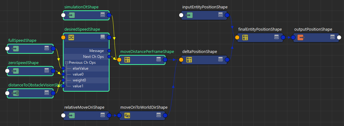

To allow the entities to slow down, the moveSpeedMultiplier node will be removed and replaced by a subgraph of nodes that will compute the desired speed for the entity.
Graph of Channel Cperators that moves entities in front of them and slow down in front of obstacles
New Channel Operator nodes are highlighted in green

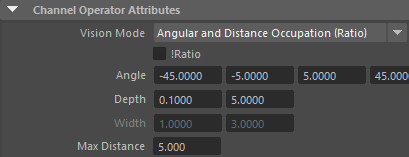

1. In the above graph, the fullSpeed (the expression is configured to 5) and zeroSpeed (expression configured to 0) are interpolated using a Multiplexer Channel Operator to obtain the desiredSpeed  (configured as interpolator default, be careful of the indices of the previous channel operators plugs, as each input has a different meaning).
2. The weight that interpolate between the full speed and 0 comes from a Sensor Input Channel Operator . The Sensor Input Channel Operator is a specific Channel Operator node that lets you input values from the Sensors into the graph of channel operator. In this case, we need the Sensor Input node to input a value that varies from 0 to 1 depending on the distance of perceived obstacles in front of the entity.

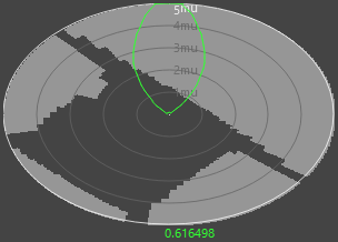

For example, we can configure it with the following parameters:
Parameters of a Sensor Input channel operator that detect when an obstacle is perceived in front of the entity
Such a sensor will check for obstacles:
  • from 0.1mu (distance parameter A) between -45° and 45° (Angular fuzz parameters A and D)
  • up to a distance of 5mu (distance parameter D) between -5° and 5°(Angular fuzz parameters B and C)
It looks like the following screenshot when using the Visual Feedback:
Sensor Input Channel Operator Visual feedback
The returned value is the ratio of obstacles / free space in the fuzz vision space (in green). It will return 0 if no obstacles are in this zone, up to 1 when the zone is completely filled by obstacles
3. Finally, the desired speed is multiplied by the simulation dt (simulationDt, with an Expression set to 0.04, which is approximately the duration of one frame à 24fps) to obtain the distance to move in a single frame (moveDistancePerFrame , configured with the multiply operator).

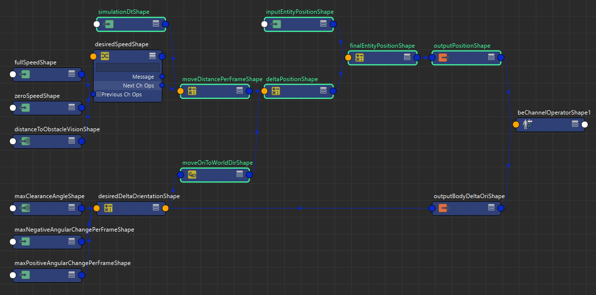

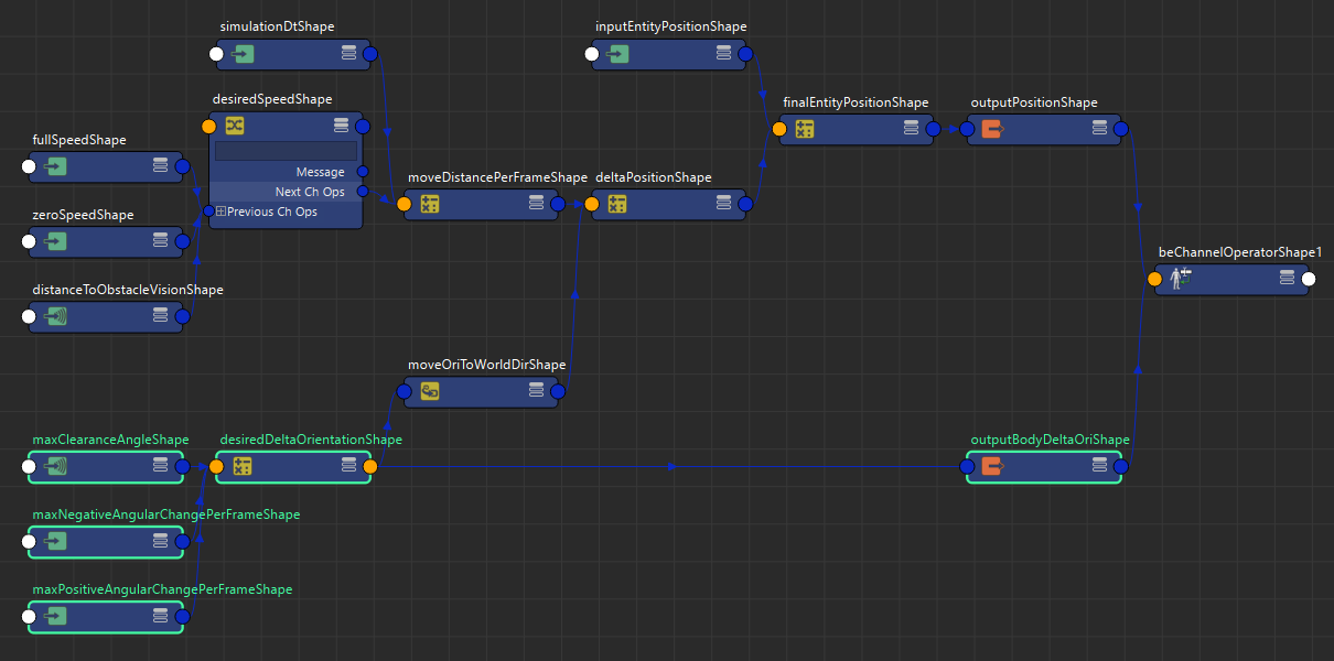

Stopping in front of obstacles is fine, but wouldn't it be better to avoid them instead? Here is the graph of channel operators that allows that.
Graph of channel operators that moves entities in the maximum clearance direction and slow them down in front of obstacles

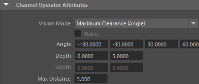

1. Add a "maxClearanceAngleChOpSensorInput configured in Maximum Clearance Angle mode. The default values for the angle and depth should be fine, but let's fine tune them to offer the entities an enhanced vision on the right side
ChOpSensorInput configured in maximum clearance angle with higher vision angle on the right side
2. To avoid fast turning rates, the sensor input is used through a clamp operation ("desiredDeltaOrientationShape configured with a clamp operator) that limit the delta orientation per frame to something reasonable. The "maxNegativeAngularChangePerFrame" is configured to -5, and the "maxPositiveAngularChangePerFrame" is configured to 5.
The filtered output is then connected to the existing moveOriToWorldDir instead of the relativeMoveOri that was just deleted.
3. The body orientation of the entity should also be modified to reflect the entity movement direction. Select the Channel Operator behavior again and add a new output . Configure it to Entity Body Orientation Delta, and rename it "outputBodyDeltaOri"
4. Connect the desiredDeltaOrientationShape.nextChOps to the outputBodyDeltaOriShape.previousChOps[0]

Open the Behavior Editor and add a Locomotion Behavior to the Entity (and configure its motions correctly):
Behavior graph with the ChannelOperator, both ActivateSensor and the Locomotion Behaviors
