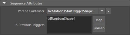

Sequence Attributes
Sequence Attributes for a Trigger and for a Trigger Operator
| Parent Container | Parent Trigger Container |
| In Previous Trigger/Triggers | Previous Trigger/Trigger Operator |
