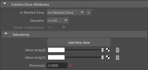

The Painted Zone trigger enables to start or stop a behavior by returning true when the position of the root bone of an Entity is contained in a painted zone of a specified color (the painted zone being represented by a Painted Zone locator).

A Painted Zone Trigger defines the following specific attributes. For common attributes see Trigger Common Attributes.
Painted Zone Attributes
In Painted Zone Link to the Painted Zone locator to check as a zone.
Operator A comparison operator (equal, greater than…)
Value Combination Is the condition matched if one of it is true (OR), or all (AND) ?
Value Array[] A reference color value. For comparisons such as "greater than" and "lesser than", it's the hue value of the color which is used (e.g. light blue > blue > dark blue)
Threshold Error allowed between the Painted Zone locator current color and the reference color for the trigger to return true
