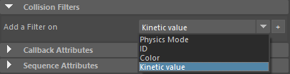

By default, a physics collision triggers returns true whenever a physics collision occurs with the entity. But it's possible to define filters on the collision to ensure the trigger returns true only for a given type of collisions.
Add Filter on
Select the filter to add:
And click on the + button to add the filter in the list of filters.
You can add as many filters as desired, but keep in mind that the trigger will return true only when all of them are valid for the same collision. See the explanation at the end of this page.

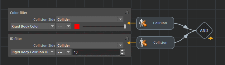

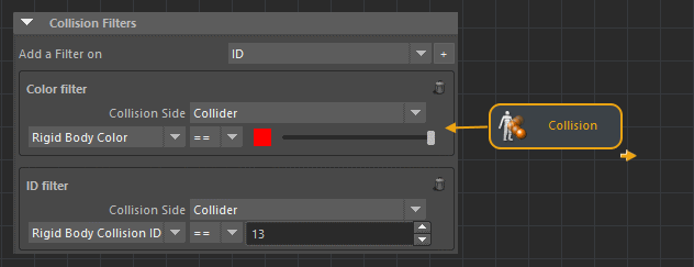

Single trigger with multiple filter versus multiple triggers with single filters
Any number of filters can be added on the trigger, it's just important to remember that the trigger will return true only if all the filters are true for the same physics' collision. For instance, the following triggers may have different results:
A single trigger with 2 filters
Two triggers with 1 filter each
The first one will return true only if a collision occurs with a collider that is both red and has an ID 13, while the second trigger might also return true if a collision occurs with a red rigid body and another collision occurs at the same time with a rigid body that has an ID 13.
