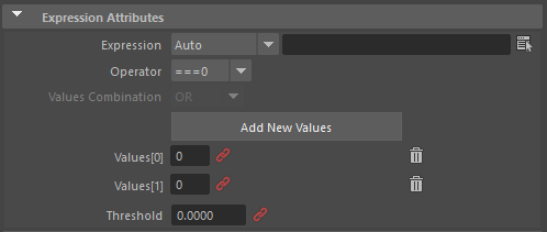

An Expression Trigger defines the following specific attributes. For common attributes see Trigger Common Attributes.
Expression Attributes
Expression The Expression or Channel to evaluate. If the return value of the Expression or Channel is of type vector, the compared value will be the length of the vector. It is advised to use the combo-box to explicitly state the type of the Operand, otherwise Golaem will try to automatically determine it (but may fail sometimes).
Operator A comparison operator (equal, greater than…)
Value Combination Is the condition matched if one of it is true (OR), or all (AND) ?
Value[] A reference value.
Threshold The tolerance around the values to the match condition
