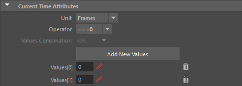

A Current Frame Trigger defines the following specific attributes. For common attributes see Trigger Common Attributes.
Current Frame Attributes
| Unit | Unit used to compare the value with (Frames or Seconds) |
| Operator | Comparison operator (equal, greater than…); |
| Value Combination | Is the condition matched if one of it is true (OR), or all (AND) ? |
| Value[] | Frame reference value |
