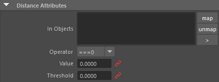

Distance Attributes
| In Objects | Distance object: Link to the Maya objects /
groups to check the distance with.
| Operator | A comparison operator (equal, greater than…) |
| Value | A reference value. |
| Threshold | Error allowed between the distance and the reference value for the trigger to return true |

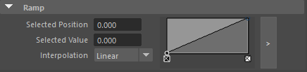

Ramp Attributes
If the Threshold value is set to some values, the Ramp controller will become available
| Ramp | Defines the probability at which the trigger will return true. The range of the ramp is [value-threshold; value+threshold] |
