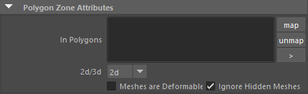

Polygon Zone Attributes
In Polygons Link to the Maya polygon or a group of Maya polygons to check as a zone.
2d/3d
  • 2d: Check if the projection of the character root is in mapped polygons.
  • 3d: Check if the character root is inside the volume of mapped meshes.
Meshes are Deformable If the polygon zone will be deformed from frame to frame, enable this option, else let it disable for better performance.
Ignore Hidden Meshes If enabled, linked Maya meshes will not be taken into account.
Advanced Attributes
Max Raycast Distance Maximum distance (in crowd units) at which a polygon should be detected for the zone detection
