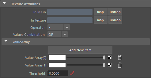

A Texture Trigger defines the following specific attributes. For common attributes see Trigger Common Attributes.
Texture Attributes
| In Mesh | Link to the Maya mesh used to extract the uv from (only if the texture mapped in the In Texture is a 2dtexture) |
| In Texture | Link to the Maya texture (2d or 3d) to check |
| Operator | A comparison operator (equal, greater than…) |
| Value Combination | Is the condition matched if one of it is true (OR), or all (AND) ? |
| Value Array[] | A reference color value. For comparisons such as "greater than" and "lesser than", it's the lightness value of the color which is used (e.g. light blue > blue > dark blue) |
| Threshold | Error allowed between the texture current color and the reference color for the trigger to return true |
