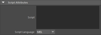

A Script Trigger defines the following specific attributes. For common attributes see Trigger Common Attributes.
Script Attributes
Script The script command to execute.
Script Language MEL or Python.
