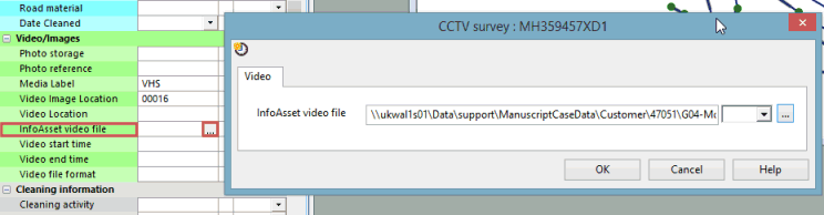

Any video files which contain CCTV or manhole surveys and defects used in InfoAsset Manager that are referenced by a linked location (file or URL) either in the InfoAsset video file field in a CCTV or manhole survey object, or on the Details tab for CCTV surveys or the Other tab for manhole surveys, can be migrated as an attachment to the current database using the Migrate survey videos option in the Network Menu.

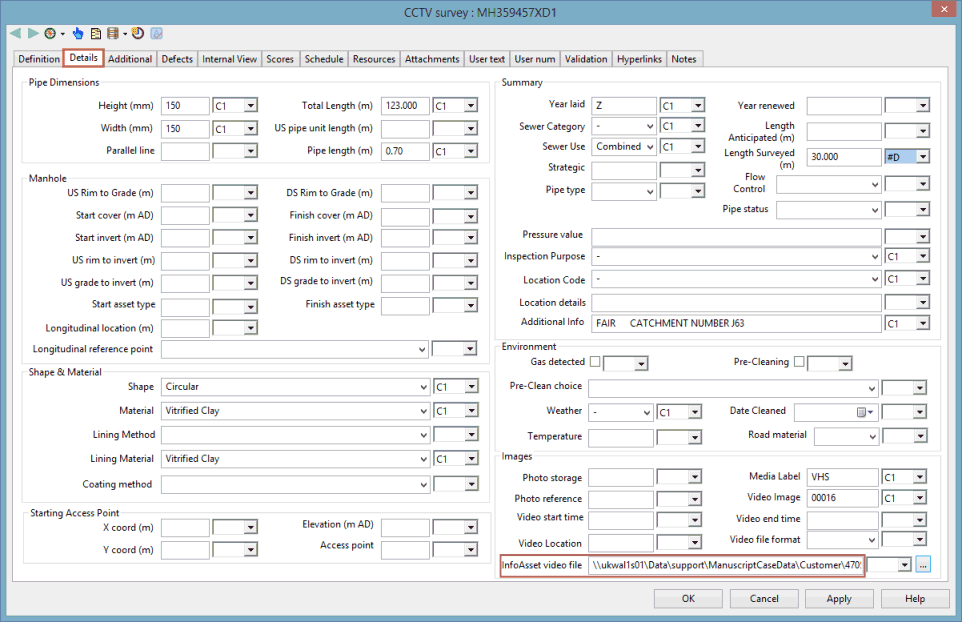

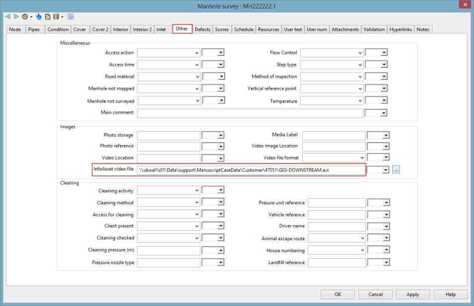

Any 'unmigrated' CCTV or manhole survey video file is normally included as a linked file in InfoAsset video file field in the object's properties editor or, if the object properties are being viewed in tabbed format, on the Details tab for CCTV surveys and on the Other tab for manhole surveys.

CCTV Survey Details Tab
Manhole Survey Other Tab

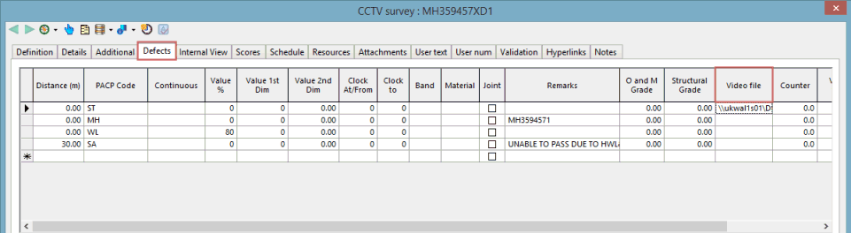

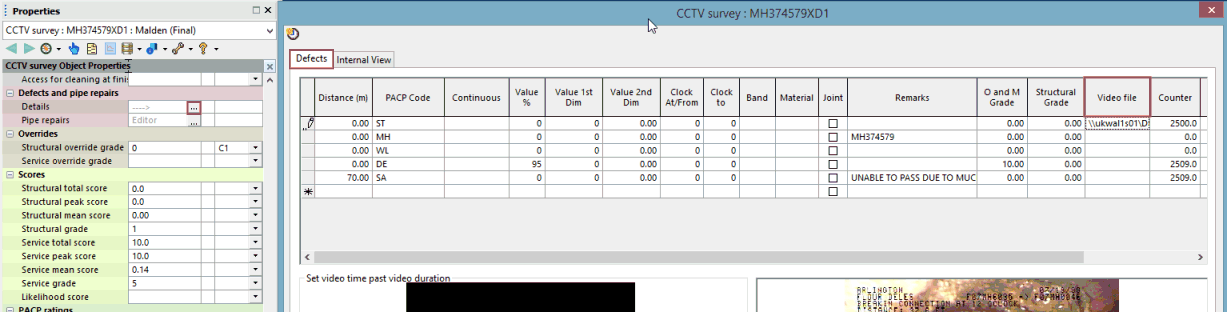

Similarly, any 'unmigrated' CCTV or manhole survey defects video file will normally be included as a linked file in the Video file column in the grid accessed from the Details field in the object's properties editor or, if the object properties are being viewed in tabbed format, from the Defects tab.

Defects Tab

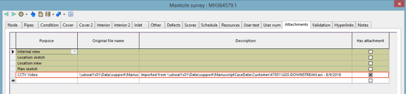

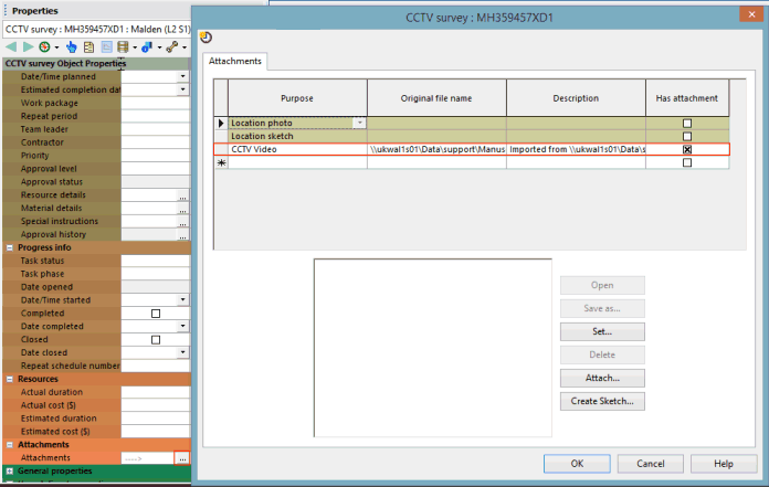

When any CCTV or manhole survey video files are migrated, file names and locations will be displayed in the grid access from the Attachments field in the object's properties editor or, if the object properties are being viewed in tabbed format, from the Attachments tab.

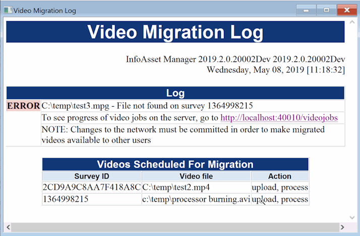

A Video Migration Log is displayed informing you which files have been migrated.
Show me

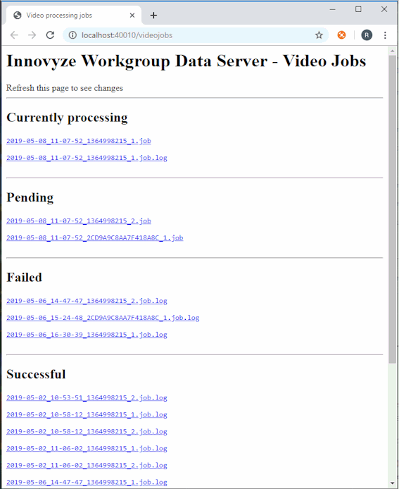

This log also contains a hyperlink to the Video Job web page on the Workgroup Data Server. Clicking on the hyperlink displays information about the jobs currently being processed, a list of pending jobs, the log files from jobs that have failed, and the log files from jobs that have succeeded.
Show me
Log files for jobs that have succeeded are purged automatically after 30 days but log files from failed jobs are retained indefinitely and can only be removed by a system administrator.
- Click on the appropriate hyperlink if you want to view any of the log files from the web page. Log files for failed jobs can be viewed from the web page to try to determine the cause of failure or, if required, to copy the file to send to Innovyze.

When the migration is complete, the Attachments tab will now include the original file names and locations of the migrated files as well as the date of the migration. The link to the survey video (previously shown on the appropriate property editor or tab) is removed, however, the file itself is not deleted but can be manually removed from the local drive or remote location when required.
