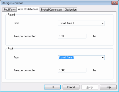

The number of paved connections is calculated assuming one connection per 300 m2 of connected paved area. The number of roof connections is calculated assuming one connection per 80 m2 of connected roof area. Both these assumptions can be defined on the Area Contribution Page. Therefore in this example there are 33.3 paved and 62.5 roofed connections.
Figure 1: Storage Compensation Dialog - Area Contributions Page

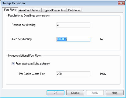

The foul only connections are converted into an equivalent connected area by assuming a housing density of 35 dwellings per hectare (or 0.02857 hectares per dwelling.) A connection length can then be calculated as before:
127.3 connections
= 3.637 hectares
= 45.46 m connection length.
The number of persons per dwelling, flow per person and housing density can be changed on the Foul Flows Page.
Figure 2: Storage Compensation Dialog - Foul Flows Page

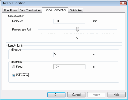

You can choose the size of the typical pipe and how typically full it is on the Typical Connection Page.
Figure 3: Storage Compensation Dialog - Typical Connection Page

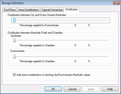

You then decide how this 46.25 m3 of storage is distributed between the up or downstream manholes and between the shafts and chambers of these manholes using the Distribution Page. By default, all the volume is applied to the upstream shaft area.
Figure 4: Storage Compensation Dialog - Distribution Page
In this example the shaft depth (ground level – pipe soffit level) = 1.395 m. Therefore the area of the shaft should be increased by
46.25 m3 / 1.395 m = 33.15 m2.
