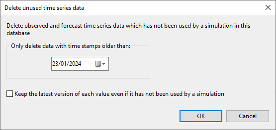

This dialog allows users to delete historical (observed and forecast) data from scalar and spatial time series data objects. This only applied to data that has not been used in simulations for the current database.
The dialog is displayed when you right-click the applicable TSD object in the Explorer window and select Open as from the popup menu, and then select the Delete unused time series data option in the Open TSD view as dialog.
Note: The Delete unused time series data option is not available for TSD objects in cloud databases.
Delete unused time series data Dialog
Caution: Deletion is immediate and occurs when you click OK. Use this dialog with care.
Dialog options
Option
Description
Only delete data with time stamps older than
Upper time limit. InfoWorks ICM will only delete values with time stamps older than the specified date.
Default is today's date.
Note: For forecasts, it is the time stamp of the forecast origin that is used, rather than the time stamped values of the forecast data. If a forecast origin is deleted all its values will be too.
Keep the latest version of each value even if it has not been used by a simulation
Check this option to keep the latest version of a value even if it has not been used in a simulation.
Let us take the example of a value with a timestamp 10/1/2013 17:00 that has been imported a week ago, then a value at the same timestamp that has been imported a few days ago, and then again today. There will be three versions of the value at this particular timestamp. So long as none of these values have been used by a run and the timestamp threshold is after 10/1/2013 17:00, they will all get deleted once you click OK. However, if this option is not checked, InfoWorks ICM will keep the last imported value (imported today) whereas it will delete the others. See illustrated example below.
OK
Close the dialog and commit the changes.
Cancel
Abort deletion and close the dialog.

Let us take a closer look at the delete behaviour now:
  1. If any of these values have been used in a simulation, and the simulation still exists in the current database, they will never be deleted using the Delete unused time series data dialog.
  2. Also if a timestamp is NEWER than the date specified in the Only delete data with time stamps older than field of the dialog,it will not get deleted. If the Only delete data with time stamps older than field is set to 5/05/2013, only the values with a 4/05/2013, 3/05/2013, 2/05/2013, 1/05/2013 and 30/05/2013 time stamp will be deleted.
  3. If the Keep the latest version of each value even if it has not been used by a simulation option is left disabled, the data will look like this after deletion (every value with a timestamp before the threshold has been deleted):
