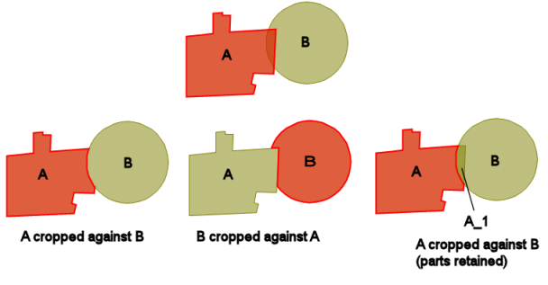

The Crop Overlapping Objects functionality can be used to:
- Remove overlaps between adjacent polygons and to ensure that vertices match on common edges. (A maximum allowable crop area as a percentage of the polygon to be cropped may be set to ensure that large overlaps are not removed.)
- Divide polygon objects into segments using lines that intersect the polygon.
- Trim lines against intersecting lines or polygons. For example: where river cross section lines intersect bank lines, the cross section lines can be trimmed against the bank lines prior to building a river reach.
It is possible to crop any polygon/polyline type against any other type of polygon/polyline or to choose to crop against objects of the same type only.

- Retain all the separate parts of the cropped objects - if this option is checked, new objects will be created if cropping of an object results in the original object being split into multiple parts. If this option is unchecked, only one part of the object is retained. (Applies to cropping of polygons and to cropping of lines against polygons. When cropping lines against lines, all parts of the line are always retained.)
- Specify which objects are to be cropped in the Crop objects selection box. Click
- Click OK.
Selected objects will be cropped against objects of the appropriate type selected in the Crop against selection. If there is no Crop against selection, objects will be cropped against all adjacent/intersecting objects of the appropriate type.
If the Do not crop polygons with overlaps greater than (% of polygon size) option has been selected, any overlaps that are larger than the value specified in the percentage size box, will not be cropped.
If the Retain separate parts option is checked, created polygon objects will be named based on the ID of the original polygon and will inherit the properties of the original polygon with the exception of Subcatchment and Storage Node IDs.

Cropping Polygons Examples
