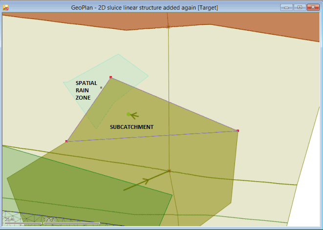

Before:
The subcatchment is composed of three vertices but there are no separate vertices at either of the two intersections with the spatial rain zone

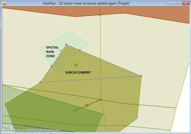

After:
The subcatchment is now composed of five vertices with two of these vertices at the intersections with the spatial rain zone
