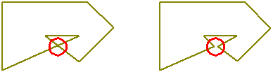

Correction is used to edit the geometry of self intersecting polygons and polylines in such a way that the shape no longer intersects itself.
Click on the image below to display some examples of correction of self intersecting polygons and polyline.
Example
Correction of Self Intersecting Polygons
Correction of Self Intersecting Polyline

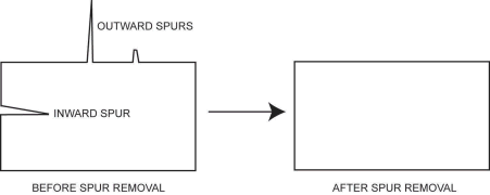

You can further thin the geometry by removing any spurs which are less than a specified width. For each selected polygon, InfoWorks ICM identifies all locations on the boundary where either the distance between two vertices or the perpendicular distance of a vertex to a nearby segment is less than the maximum specified spur width. For each of these locations, the polygon is regarded as being divided into two parts; the part with the smaller area is identified as the spur (to be removed) and the larger part as the main polygon (to be retained).
InfoWorks ICM sorts all spurs in ascending area sequence and attempts to remove each one in turn, subject to any specified polygon area constraint.
The spurs can be inward or outward. Click on the image below to display an example of inward and outward spur removal.
Example
