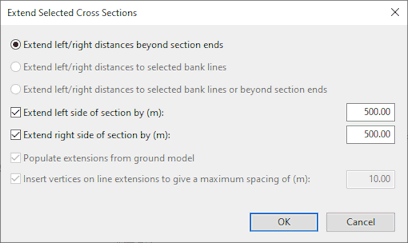

This dialog is used to extend the left, right or both ends of one or more selected cross sections by a specified distance.
If one or more bank lines are also selected, you can choose to:
  • Extend the section ends to the intersection with the nearest selected bank lines that are located within the specified distance from the section ends.
  • Extend the section ends to the intersection with the nearest selected bank lines that are located within the specified distance from the section ends, and, if a bank line is not found, extend the ends of the applicable cross section by the specified distance.
If a ground model has been loaded onto the GeoPlan, you can choose to:
  • Set the elevation for new cross section vertices according to ground model heights.
  • Set the maximum spacing between the new vertices on the extended cross sections.
The dialog is displayed by selecting Geometry Extend Selected Cross Sections from the Model menu.
Dialog description
Item Description
Extend left/right distances beyond section end
Enabled when at least one cross section line is selected on the GeoPlan.
Extends, by the distance specified in the Extend left side of section by and/or Extend right side of section by boxes, the end vertices of the selected cross sections.
Extend left/right distances to selected bank lines
Enabled when at least one cross section line and at least bank line are selected on the GeoPlan.
Extends the selected cross sections to the intersection of the nearest selected bank lines that lie within the distance specified in the Extend left side of section by and/or Extend right side of section by boxes.
Any cross section, for which a bank line is not found within the specified distance, will not be extended.
Extend left/right distances to selected bank lines or beyond section ends
Any cross section, for which a bank line is not found within the specified distance, will be extended by the specified distance.
Determines whether or not the left side (when looking downstream) of all selected cross sections are to be extended. The section will be extended in the direction of the last segment of the section on the left side.
If checked (default), the box to the left is enabled to let you specify the distance that the selected sections are to be extended by.
By default, the value of the last specified distance is displayed in the box which can be changed as required.
Determines whether or not the right side (when looking downstream) of all selected cross-sections are to be extended. The section will be extended in the direction of the last segment of the section on the right side.
Populate extensions from ground model
Enabled and checked (default) when a ground model is opened on the GeoPlan.
It determines whether or not any new cross section vertices have their elevation (Bed level property) set according to the ground model heights at those points.
If unchecked, no elevations are set for when the cross section vertices are generated.
Insert vertices on line extensions to give a maximum spacing of
It determines whether or not a specified distance between the new vertices is to be applied when the cross sections are extended.
If checked, the maximum distance between vertices can be specified in the adjacent box.
OK
Extends the cross section line by generating new vertices according to the specified options and closes the dialog.
Further information about the extension process can be found in the Extending Selected Cross Sections topic.
When the extension operation is complete, the Extend Cross Sections Report window is displayed. This contains information about the number of cross sections extended, number of failures and reasons for failures.
Cancel Cancels the operation and closes the dialog.
