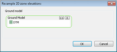

This dialog is used when recalculating ground elevations of existing 2D mesh elements within selected 2D zones. It is displayed by selecting Meshing
Resample 2D zone elevations from the Model menu.
Note: It is not possible to resample 2D mesh elements in an
InfoWorks 2D zone if Subgrid Sampling is selected (i.e. the Subgrid Sampling box is checked in the properties for a
2D zone or a
mesh zone within the 2D zone).
Select the ground model from which elevations are to be sampled and click OK. New ground levels for mesh elements are calculated by sampling the ground model selected in the dialog.
