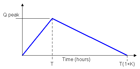

Each set of RTK parameters defines a triangular graph against time, where:
- R is the area under the graph representing the proportion of rainfall falling on the subcatchment (InfoWorks networks) or node (SWMM networks) that enters the sewer system
- T is the time from the onset of rainfall to the peak of the triangle
- K is the ratio of 'time to recession' to the ' time to peak' of the hydrograph

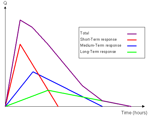

Three sets of RTK parameters can be defined, representing short-term, medium-term and long-term rainfall response. The three triangular graphs are combined to define the Unit Hydrograph.
RTK Hydrograph and Component Hydrographs
