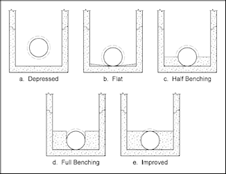

Benching method
Benching method options:
Database Value
Depressed
Flat
Half Benching
Full Benching
Improved
Access hole benching methods (Figure 7-6 FHWA HEC 22 Urban Drainage Manual)
