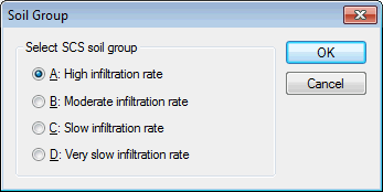

This dialog is displayed when you click the Soil Type button on the Horton Infiltration Parameters page of the Runoff Surface Wizard.
Use it to add default parameters for the one of the four SCS soil types instead of entering you own values on the Horton Infiltration Parameters page.
