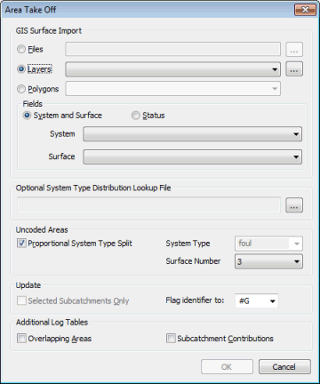

This dialog is used when carrying out
Area Take Off. The dialog is displayed by choosing Subcatchment
Area take off from the Model menu. This allows automatic calculation of runoff surface areas and the contributing areas of subcatchments using data imported from GIS.

GIS Surface Import
The Area Take Off Dialog allows the digitised GIS Impermeable Area Survey (IAS) data to be read by:
- Browsing for a GIS file: Click the
button to identify the table.
- Selecting a Layer in the GeoPlan View: Select from the dropdown or click the
button to display the
GIS Layer Control Dialog.
- Selecting polygons imported from GIS: Select polygon Category field from the dropdown.
Fields
The Fields dropdowns are used to select the GIS table/layer fields containing the system and surface codes or the Status codes of the IAS polygons.
IAS imported polygons should contain system codes in the User Text field and surface codes in the User Number field (or Status codes in the User Text field when using the Status coding method).

Update Selected Subcatchments
If there are no subcatchments selected, the area take-off is performed for the entire network. If one or more subcatchments have been selected, checking the Update Selected Subcatchments Only box restricts the calculation to the selected subcatchments; the area details are unchanged for other subcatchments in the network.
The flag selected in the Flag Identifierfield will be applied to fields that are updated by carrying out area take-off. The default flag offered is #G (from geographical data). A different existing flag can be selected from the dropdown. Alternatively, a new flag can be created by clicking on New Flag, which displays the User Defined Flags dialog.
Uncoded Areas
Uncoded areas can be applied to a particular surface number. Uncoded areas can also be applied to a specified surface type or split between surface types in the same proportion as coded data.
If a System Type Distribution Lookup File has been specified, names of mixed system types defined in the lookup file will be added to the dropdown of System Types to which uncoded areas can be applied.
