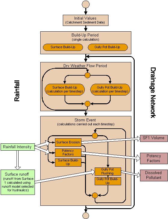

The diagram below describes the operation of the Surface Pollutant Model as part of a simulation.
- You can set initial values for sediment mass on the catchment surface.
- You can model the build-up of sediment during the dry spell prior to a simulation.
- Once the simulation starts, you can have alternating dry weather periods and spells of rainfall:
- During dry weather, build up of sediment and pollutants continues.
- During a storm, sediment and pollutants enter the drainage network. Buildup also continues during storms.
Inputs to the model are down the left hand side of the diagram. Output to the drainage network is shown down the right hand side.
In the main boxes, the surface sediment process is on the left and the gully pot pollutant process on the right.
Schematic diagram of the Surface Pollutant Model during simulation

The three parts of the surface sediment calculation take place in parallel. They all use the initial sediment mass at the start of the timestep.
Surface erosion and the potency of attached pollutants are calculated using the rainfall intensity.
All the sediment washed off the surface is treated as Sediment Fraction 1.
The rate at which eroded sediment runs off into the system is calculated using the runoff model chosen for the hydraulic calculations.
The calculations use the runoff from Runoff Surface 1 and Runoff Surface 2 defined in the Land Use Definition. By convention these are both impervious surfaces - Runoff Surface 1 is the road surface and Runoff Surface 2 is the roof area.
Surface build-up continues during storm events and the build-up is calculated in the same way as during dry weather periods.
Gully pot flushing
The amount of pollutant flushed out of gully pots is calculated using a value for surface runoff.
The calculations use the runoff from Runoff Surface 1 defined in the Land Use Definition. By convention, Runoff Surface 1 is the road surface.
The runoff is calculated by the hydraulic engine using the runoff model you selected for hydraulic calculations.
After the gully pot flushing calculation, the software calculates the amount of build-up in gully pots. The calculation is the same as that used during dry weather periods.
Build-up
During periods of rainfall, build-up of sediment and pollutants continues, even though the amount is probably insignificant compare to wash-off.
The calculation is carried out in the same way as during dry weather flow periods. See Surface Pollutant Build-Up and Gully Pot Pollutant Build-Up.
