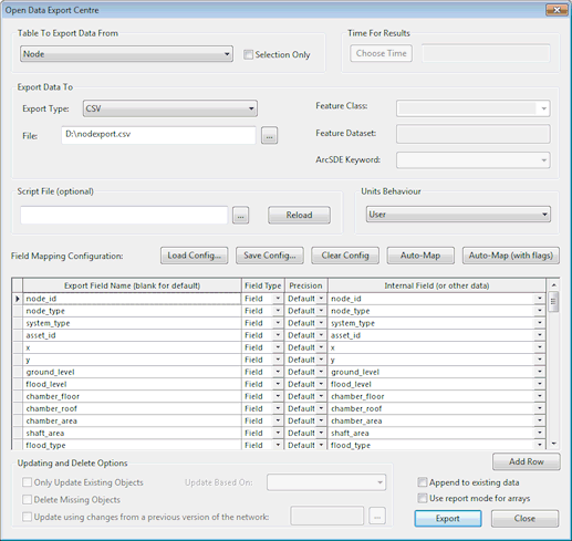

This dialog is used when exporting data to external data sources via the Open Data Export Centre.
It is displayed when you:
- Right-click the
version controlled item and choose Export
using Open Data Export Centre from the popup menu
- Choose Export
using Open Data Export Centre from the Network menu when a network is open
- Choose Open Data Export Centre from the Results menu when available
- Right -click a simulation and choose Export
- Right-click a risk analysis simulation or a risk analysis result object and choose Export

Open Data Export Centre Options
Dialog Section |
Description |
Table to Export Data From |
Time For Results |
Choose return period |
Export Data To |
Script File (optional) |
Scripts can be used to refine the export process. This is an advanced option. Contact Innovyze for further information on using a script to control export. |
Units Behaviour |
Select from User Units to export values using the current display units, or InfoWorks ICM Units to export values as InfoWorks ICM native units. |
Field Mapping Configuration buttons |
Use the Field Mapping Configuration buttons to apply saved mappings to the Field Mapping Grid:
Field Mapping Grid |
The field mapping grid allows the mappings for individual data fields to be set up. The grid contains a variable number of columns. Some columns only appear for some data types, and some columns will be disabled depending on the values of other columns. See the Field Mapping Grid section below for further details. |

Field Mapping Grid
The grid allows the mappings for individual data fields to be set up. The grid contains a variable number of columns. Some columns only appear for some data types, and some columns will be disabled depending on the values of other columns.
Column |
Description |
Export Field Name |
The name used for the column, either in the database or file for GIS or database files, or in the first row for CSV and tab separated data files. If this field is left blank a sensible name will be generated when the file is exported. Therefore you only need to put something in here if you do not like the default value. |
Field Type |
There are currently 5 field types:
Data Type |
The data type column allows you to override the normal export data type for this data field. This column is hidden for comma and tab separated variable files. Data is always exported to these file types as text. The possible data types are:
By default, fields are exported in the same format as they are held in InfoWorks ICM. These formats are predominantly Text and Double. You can choose to export any field in any format. If you try to export a string that cannot be represented as a number in one of the number formats, you will get a warning message after the export. You will get a warning message for every failure, so if you have a long list of objects it could be a long list. It may be perfectly legitimate for you to export text fields as numbers. For example, if:
If you export a text or numeric field as a Boolean value, the Boolean value will be set to true if:
Otherwise, the Boolean will be set to false. |
Length |
Applicable to fields of Data Type Text only. This column is hidden for comma and tab separated variable files. The default length for text fields is the maximum length of the field in InfoWorks ICM. If you are exporting something using SQL or Ruby Script into a text field, InfoWorks ICM scans the exported text, and sets the length of the longest string as the default. If you choose a length for a text field and try to export strings that are longer than this maximum, the exported text will be truncated and you will receive a warning for each occurrence. |
Precision |
Applicable to fields of Data Type Text only. There are two reasons for changing the default precision:
Internal Field (or other data) |
The entry in the Internal Field column will vary depending on the value selected in the Field Type column.
