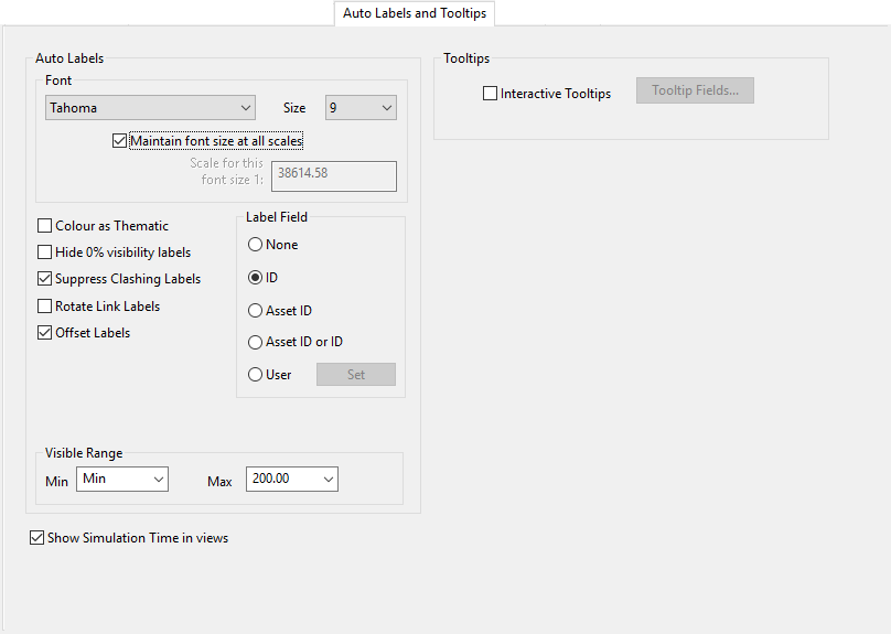

Use this page to:
  • set how the auto labels on the GeoPlan window are displayed
  • customise tool tips so that the desired information is displayed when an object is hovered over on the GeoPlan.
This page is opened by right-clicking a GeoPlan, selecting Properties & Themes, then clicking the Auto Labels and Tooltips tab.
Settings are used only for the current GeoPlan view. If the current GeoPlan window is closed, the settings will be lost (but see Network Editing Properties - Save Options dialog).
Auto labels and tooltips page
