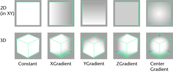

Select which predefined set of values you want to place in the container:
- Constant
Sets the value to 1 throughout the fluid.
- X Gradient
Sets a ramp of values from 1 to 0 along the X axis.
- Y Gradient
Sets a ramp of values from 1 to 0 along the Y axis.
- Z Gradient
Sets a ramp of values from 1 to 0 along the Z axis.
- -X Gradient
Sets a ramp of values from 0 to 1 along the X axis.
- -Y Gradient
Sets a ramp of values from 0 to 1 along the Y axis.
- -Z Gradient
Sets a ramp of values from 0 to 1 along the Z axis.
- Center Gradient
Sets a ramp of values from 1 at the center, to 0 along the edges.
