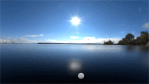

- Start off by creating a polygon plane that can be used as the ocean surface:
Ocean Material
- Create a standard_surface shader and assign it to the polygon plane. Set the base_weight to 0. Increase the specular_weight to around 1. Increase the transmission_weight to 1 (this will make the water transparent). Finally set the specular_IOR to that of water (1.33).

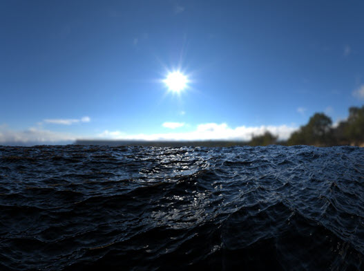

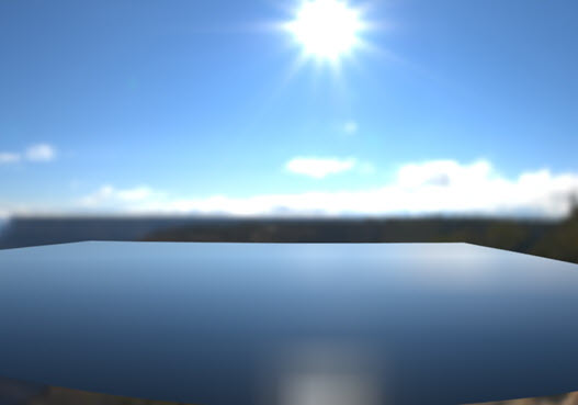

- Render the scene. There is no displacement! That is because we don't have enough subdivisions in the geometry of the sea plane.
- Select the plane and under the Arnold attributes, change the subdivision_type to catclark and increase the number of iterations. Start off with a low number like 3:
subdivision_type: catclark, subdivision_iterations: 3.

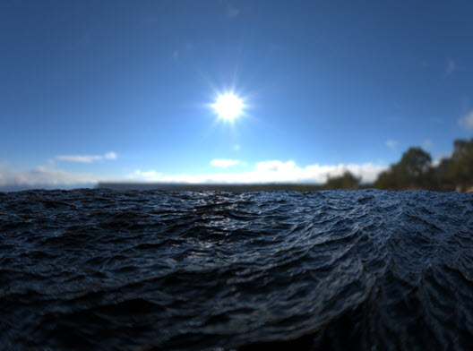

- The sea looks ok, but it really needs more detail. Increase the subdivision_iterations to 8. Be careful not to increase this value too much as memory use and render times can increase dramatically with each increment (each iteration quadruples the geometry).
subdivision_iterations: 8. More detail can be seen in the sea waves.

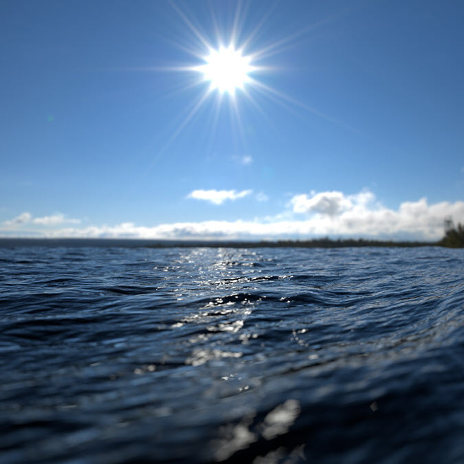

Lighting

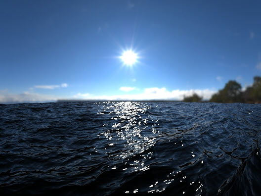

- Finally, add a directional light to the scene. We can use this to exaggerate the effect of the sun on the sea surface, thereby bringing out the highlights on the sea surface.
Rendered with a directional light
- Increasing the Angle attribute of the directional light will increase the angular size of the light, thereby producing a larger specular reflection on the sea surface.
Angle 5

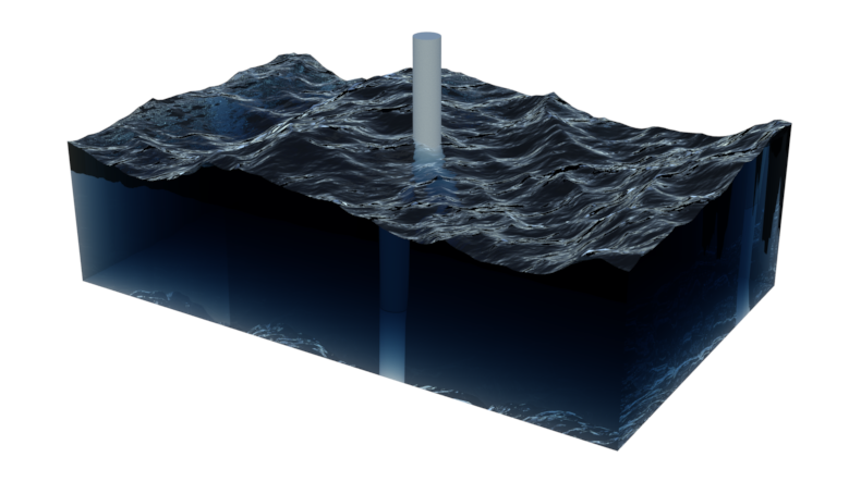

Transmission
Light that penetrates the ocean surface is 'refracted' due to the fact that light travels faster in the air than in water. When the light reaches the water it will be scattered or absorbed by particles in the ocean. As the ocean becomes deeper (denser), the water will decrease the depth of light penetration. We can replicate this effect quite easily using the transmission attribute in the standard_surface shader. The effect can be seen when placing an object inside the ocean surface. We can see that the longer light travels inside the mesh, the more it is affected by the blue transmission_color.
transmission_color: white | transmission_color: blue |
When applied to the ocean shader we can see the effect that transmission_color and depth has on the white cylinder inside the closed surface ocean below:

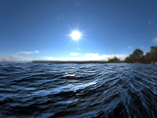

A more realistic look is to make the water transparent and then place a plane below the water that has the color of ocean water. In the example images below the ocean floor's standard_surface shader has an emission_scale of 1 and a blue/green emission_color. Increasing the subdivision_iterations has also helped to reduce the number of black patches on the displaced sea waves.
subdivision_iterations: 3. Black patches are visible | Increasing the subdivision_iterations to 8 reduces the problem |
The dark patches behind the wave crests (self-reflection) can also be improved by increasing the specular_ray_depth in the render settings.
specular_ray_depth: 1 | specular_ray_depth: 2 |
