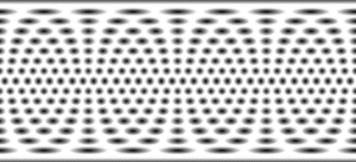

To extrude from a texture
Generate surface features from vertex and pixel colors
  1. Select the part in the project tree and choose Modify > Texture and color.
  2. If your part has texture or color already, you can skip this step, otherwise apply color or texture now. In the latter case, you can keep Texture and color open; you do not have to apply, close, and reopen the editor to proceed with extrusion.
  3. Adjust the values as necessary.
  4. Click Extrude for a preview. You can undo this if needed to start over.
  5. Click Apply changes to produce the part with the imposed texture.

Displacement for white, Displacement for black Sets the bracket of displacement. A positive value pulls the colored area out of the original geometry. A negative value subtracts the colored area from the original volume. Depending on which parameter receives the more positive number than the other, the extrusion result can be a positive or a negative of the original texture.
