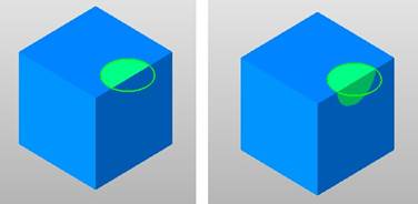

Left: A selection tolerance below 90°. Right: A selection tolerance above 90° and the brush now covers the adjacent side of the box.
