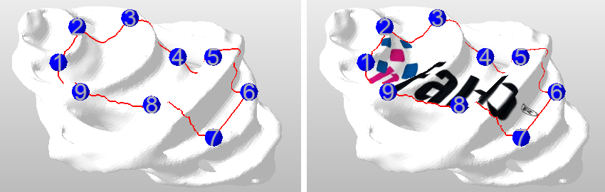

- Begin clicking on the part to define the region to contain the texture. Each subsequent click adjusts the shape of the enclosed region.

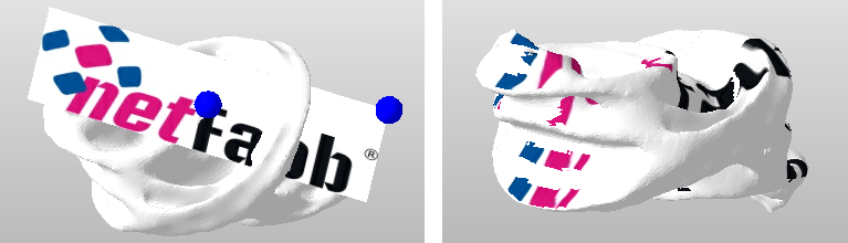

- In the context view, drag the blue dots on the grid to define the region of the texture to be applied to the part.
- Click Show Preview to see how the texture is applied to the part.
- Click Add Texture to apply the texture to the part.
Left: Define the area on the part containing the texture. Middle: Define the area of the texture to be applied to the part. Right: Preview of the advanced texture.
A part textured with the project mode.
A part textured in the advanced mode.
