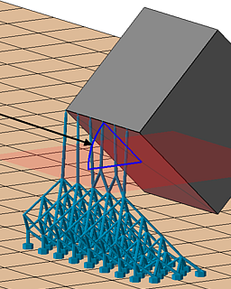

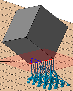

Builds a scaffolding under and around the part and supports it with bars
This is an area-supporting action. It fills the volume underneath supportable surface areas, subdivides the determined support volume into unit cells, and fills these cells with the Star topology. From the scaffolding thus created, individual bars sprout to cover the final distance to support the respective downskin clusters.
If possible, and enabled, whole groups of eight cells (2×2×2) are collapsed into single cells.

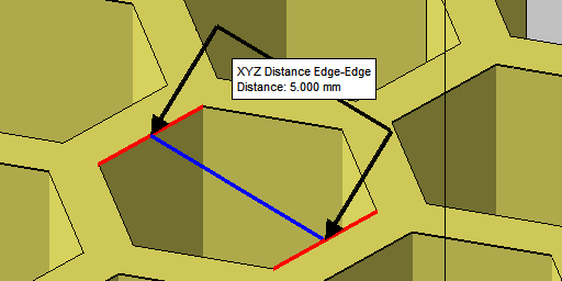

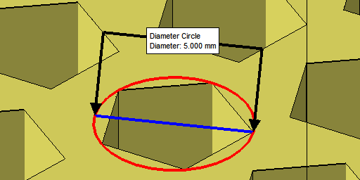

| Cell size |
Size of the holes for Rectangular and Hexagonal, measured at right angles between wall surfaces, or outer diameter for Circular and Column, respectively ![]()
Rectangular, Hexagonal, Circular, Column only |
