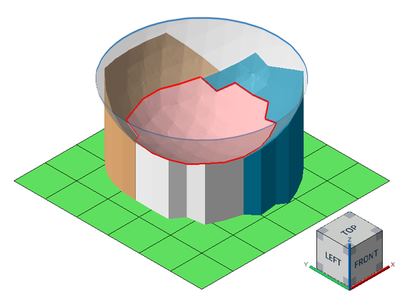

| Cluster type |
Classifies clusters by the angle between normals of triangle pairs along cluster borders that have a stretch of cluster border run between them. If more than 75 % of a cluster's border length lies within converging pairs, a cluster is considered concave. If more than 75 % of cluster border lies within diverging pairs, the cluster is considered convex. In-between, a cluster is considered neither.
Tip: To restrict supporting to those areas which are neither convex nor concave, support the convex and concave ones first and follow up with a catch-all while disallowing duplicate support.
![]() The top half of a hollow sphere, containing a concave and convex cluster. Each cluster is covered by a different action with its own detection settings each. |

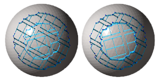

| Duplicate support |
This option controls whether triangles of a cluster gets supported with the respective action even when a previous action in the script has already applied some supports there. For example, use overlapping supported areas to create stepped support density that is stronger where the downskin's angle is particularly shallow. ![]() This sphere was supported with a script that included two actions with different values for cluster detection each. The smaller cluster was determined first (with a critical angle smaller than the larger cluster's). Left: Duplicate support tolerated. Right: Avoided. Note: Technically, this compares the detected clusters first before actually generating any supports: If you have two support actions that both detect effectively the
same clusters, the second action (set to avoid duplicate clusters) does still
not generate any supports even when there would be space in the cluster to fit. For those cases, set this to tolerate duplicate support and also set
Keep distance to support to
Yes.
Avoid, Tolerate |
