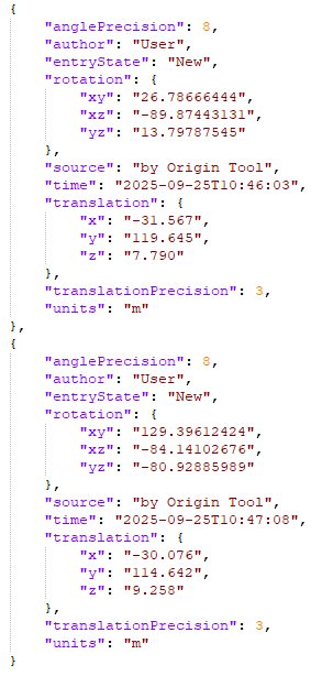

Example Log Entry Format (UI & File):

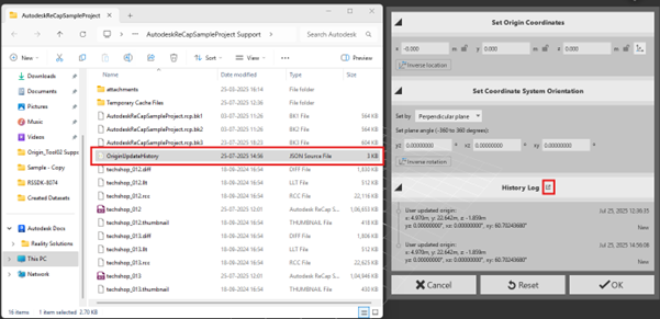

History Log panel in the UI after multiple updates:
Open Log Folder icon/button and opened folder view:

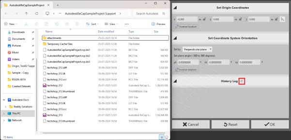

Gray-out state after deleting the log file
