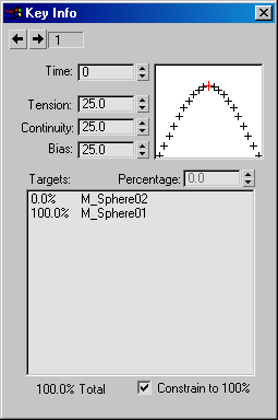

You can change morph target weighting using controls in the Barycentric Morph Controller Key Info dialog.
  • Select a Morph object > Track View - Dope Sheet > Right-click a morph key. > Barycentric Morph Controller Key Info dialog

Current Key
Specifies the current key that you're adjusting.
Time
Specifies where, in time, the current key is placed.
Tension/Continuity/Bias
Adjusts the TCB parameters of the key spline interpolation.
TCB Spline
Displays the key interpolation spline.
Targets
Lists all morph targets for the object, along with the percentage of their influence at the current key. The total percentage of all targets is displayed below the window. You can select any target in this window, and then adjust its percentage of influence using the spinner at right.
Percentage
Sets the percentage of influence for the target selected in the list window. Percentage values can be negative as well as greater than 100 percent.
Constrain to 100%
Limits total weight of all targets to 100 percent. As you increase or decrease the percentage of a selected target, the other targets adjust accordingly. The adjustment takes the form of balancing all of the target percentages so that their relative weights remain the same.
When this checkbox is turned off, you can adjust the weight of each target without affecting the others, and create a total that's greater or less than 100 percent. Totals greater than 100 percent cause the morph object to scale up in size, while totals less than 100 percent cause the morph object to scale down. Note that this checkbox is global, and not confined to a single key or track.
