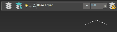

Working with Animation Layers

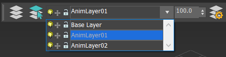

The animation layers list on the Animation Layers toolbar works as follows. For common workflow examples, refer to the Procedures section, following in this topic.
- The list displays all existing layers for the selected object. If the selected object isn't layer-enabled, “(Enable Layers)” appears instead.
- By default, the Base Layer is the active layer when you first layer-enable an object. This layer stores any existing animation keys when you layer-enable an object.
- Every layer you create after layer-enabling an object becomes the new active layer and appears after the previous one in the list.
- The active layer stores all newly created animation keys.

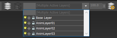

- When you select an object, its active layer is automatically chosen. When expanded, the drop-down list highlights the active layer.
- When you select multiple objects that have different active layers, “(Multiple Active Layers)” appears.
The drop-down list displays all common layers (that is, with the same name); layers not common to all are unavailable.
When you select multiple objects, layers not common to all are unavailable on the drop-down list.
- You can toggle any layer in the expanded list by clicking its light bulb icon. Turning off a layer hides its animation without deleting it.

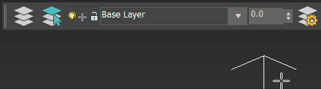

- Make sure the teapot is selected, then click
(Enable Anim Layers).
- On the Enable Anim Layers dialog, turn on only the Position track, and click OK.
The new Layer controller now nests your teapot's animation.

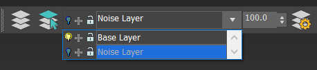

Example: To turn a layer on and off:
- On the Animation Layers toolbar, expand the drop-down list.
The list currently contains both the original base layer and Noise Layer from the previous procedure.
- Move your cursor across the list and click the light bulb icon next to
Noise Layer.
This turns off the layer and hides the Noise controller track from the rest of the tracks.
- Drag the time slider and notice how the teapot does not shake anymore.
- Try turning on and off both layers in the list to see the results. When finished, turn both layers on.

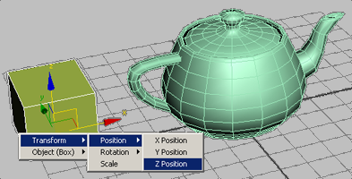

Example: To link two objects with wire parameters using the Layer Controller's output track:
- Make sure both layers listed on the Animation Layers toolbar are on, as indicated by the light bulb icons.
- Create a box next to the teapot.

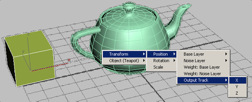

- Right-click it and choose Wire Parameters from the quad menu.
- Navigate through the pop-up menu and choose Z Position.

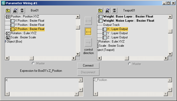

- A dashed line appears. Click the teapot and choose the X Output Track from the pop-up menu.
3ds Max opens the Parameter Wiring dialog, with the two parameters highlighted. Click the left directional arrow button to control the cube's position using the teapot's animation.
- Click Connect and close the dialog. Drag the time slider and notice how the cube's position in Z matches the teapot's layered animation in X.

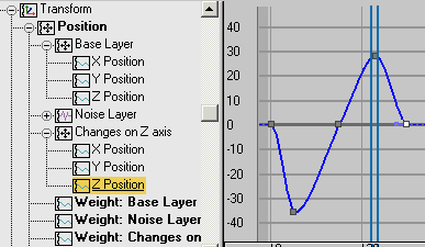

(Paste New Layer). On the Rename Anim Layer dialog, enter “Changes on Z axis” as name and click OK.
This new layer becomes the active layer.
- While
is on, move the teapot on the Z axis at frames 5 and 20.
This animation update only affects the position tracks of the active layer.

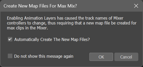

Remapping is necessary in this case because enabling Animation Layers causes the full controller names to change. For example, if a sphere's X position track before enabling Animation Layers is Sphere01\Transform\Position\X Position, then after enabling animation layers it might change to Sphere01\Transform\Position\Base Layer\X Position (the layer name is inserted into the controller name).
If you accept the default dialog option, to create the new map files automatically, 3ds Max automatically generates any necessary XMM files with the same names as the XAF files and places them in the same directory as the original map files, or if no map files exist, in the same directory as the XAF files. Thereafter, when you open this scene file the map file is loaded automatically and no additional mapping is required.
However, if you turn off Automatically Create The New Map Files? before clicking OK, no map files are generated, and the next time you open the scene file you're prompted to create map files. Without map files, the animation doesn't appear correctly.

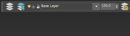

- [animation layer list]
- Lists all existing layers for the selected object. Each layer in the list contains toggle icons to turn it on or off, as well as include or exclude it from the controller's output track. Set the active layer by choosing it from the list.
See Working with Animation Layers, preceding in this topic.
- [weight]
Sets a global weight for the active layer, which affects If the active layer is shared by several objects (ex. Base Layer), changing its weight affects them all.

Disable Anim Layer -
Removes the Layer controller from the selected object. The animation keys on the Base Layer revert to the original controller. A dialog prompts for confirmation.
Note: Before you can disable the Base Layer, you have to delete or collapse all layers above.
