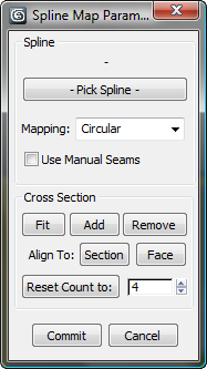

The Spline Map Parameters dialog opens.
- Click the Pick Spline button, and then select the spline to use for mapping. Either click the spline in the viewport or press
H and select it by name.

Spline group
These settings are for overall mapping.
- Pick Spline
Lets you specify a spline to use for mapping. Click this button and then select the spline. After you specify the spline, its name appears in the space above the button.
If the spline contains several elements, the element used for mapping is the one you click.
- Mapping
Lets you specify how the modifier projects the map onto the mesh.
Circular Use for objects with a circular cross-section, like a tube.
With circular projection, the cross-sections are circular by default. You can change the mapping by transforming these cross-sections. For example, you can create a spiral mapping effect by rotating the cross-sections around their local Z axes by successively greater amounts.
Planar Use for flat objects, like a road.
With planar projection, the cross-sections are lines. For best results, make sure the cross-sections are parallel to the mesh surface, and perpendicular to the spline used for mapping. In most cases, this happens by default.
- Use Manual Seams
When on, uses the pelt seam as the texture border. When off, uses the green seam line built in to the spline-mapping gizmo.
This option is available only with Circular mapping, and works best with relatively simple objects with open ends.
Cross Section group
After you assign a spline in the Spline group (see preceding), 3ds Max applies the spline mapping to the object, creating a cross-section for each vertex in the spline. The settings in this group let you manipulate the cross-sections. To select a cross-section, click it. To select all cross-sections, press Ctrl+A.
In Spline mode you can transform selected cross-sections in the local coordinate system, moving, rotating, and scaling them as you like to adjust the texture coordinates.
- Fit
Resizes selected cross-sections to match the adjacent geometry.
Note: With asymmetrical geometry, Fit might give unexpected results because it adjusts the cross-section to the closest parts of the neighboring geometry along the cross section's local X and Y axes. In such cases, you might need to transform the cross-section manually to get the best fit. - Add
Lets you add cross-sections for finer control over the interpolation of the mapping between cross-sections. Click this button and then click the spline where you want to add a cross-section. The mouse cursor changes to a crosshairs when over the spline. Continue adding cross-sections as necessary, and then click the button again to exit Add mode.
- Remove
Deletes any selected cross-sections. The end cross-sections cannot be deleted.
- Align To:
- Section Aligns the selected cross-sections to another cross-section. Select the cross-sections to align, click Section, and then click the target cross-section. Aligned cross-sections pick up the orientation and scale of the target.
Face Aligns the selected cross-sections to a mesh face on the modified object. Select the cross-sections to align, click Face, and then click the face to align them to.
This tool is most useful with Planar mapping.
- Reset Count to
Lets you specify the number of evenly spaced cross-sections. Set the numeric value and then click the Reset Count To button.
This tool is useful when the mapping spline has many vertices, and you want to reduce the number of cross-sections to a manageable number.
