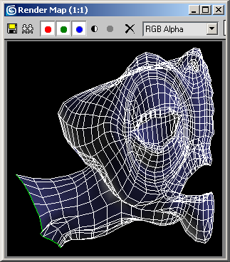

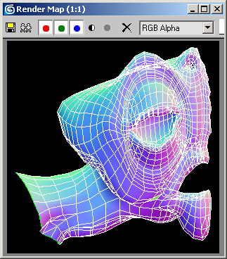

Mode=Normal
Mode=Shaded

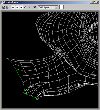

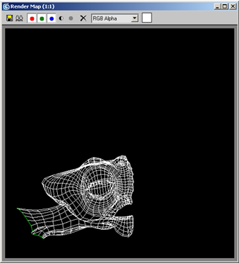

Small UVs
Template image is too small.

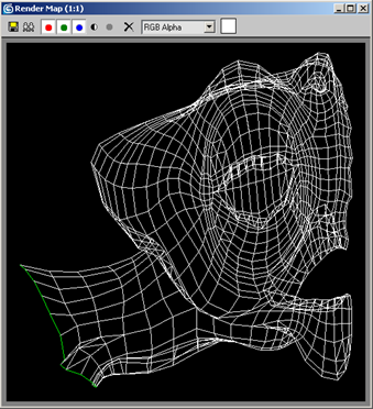

Large UVs
Template image is too large.
UVs fit
Template image is just right.
