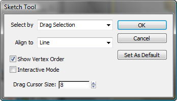

- Choose Sketch Vertices.
- On the Sketch Tool dialog, from the Select By drop-down list, choose Drag Selection, if necessary.
- From the Align To drop-down list, choose Free Form, if necessary.
- Make sure Show Vertex Order and Interactive Mode are on. Leave Drag Cursor Size at the default setting.
- Click OK to close the dialog.

Interface
- Select by
Lets you choose how to select the vertices to sketch:
- Pick Selection Lets you pick the vertices one by one. When you click OK, a Pick cursor appears comprising a + sign and the letter P; when the cursor is over a vertex, the + sign becomes larger. To finish picking, right-click, and then drag to sketch. After sketching, you return to Pick mode, and so on. To exit, right-click.
- Drag Selection Lets you pick multiple vertices by dragging. When you click OK, the mouse cursor appears as a circle. After you drag to select vertices, release the mouse button, and then drag (or Alt+click) to sketch. As with Pick Selection, the mouse cursor continues to alternate between Select and Sketch modes until you right-click to exit.
- Use Current Selection Uses the current selection; you cannot change the selection while using the tool. If the current selection is edges or faces, Sketch uses all vertices attached to selected sub-objects.
- Align To
Lets you choose how to sketch:
- Free Form Drag to sketch free form (like drawing with a pencil), or Alt+click to sketch connected
- Line Drag to sketch a single, straight line segment.
- Box Drag diagonally to sketch a rectangle.
- Circle Drag outward to sketch a circle, and then move the mouse in a circle to rotate the circle.
- Show Vertex Order
Displays numbered labels that indicate the order in which vertices were selected and will spread out during sketching.
- Interactive Mode
Shows vertex positioning as you sketch. Turn off for faster feedback.
- Drag Cursor Size
Sets the size of the mouse cursor used while dragging a selection. Default=8. Range=1 to 15.
- OK
Accepts the changes and closes the dialog.
- Cancel
Undoes any changes and closes the dialog.
- Set As Default
Makes the current settings the defaults for the current session.
