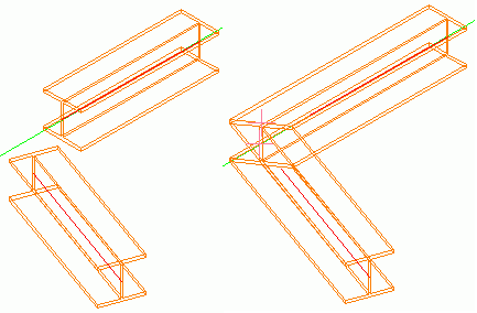

Create a miter cut
In a miter cut the intersection is created vertically or at the bisecting line. Each of the two beams gets a processing object at their end. The sections insertion axes must lie in the same plane. For sections that intersect, the longer parts are cut to miter.
The feature is based on rules, so the properties can be modified through the connection object. To modify the properties, display the connection object.
To access the command
Features tool palette:
Command line: _AstM4CrConByVB FitterJoint2
To create a miter cut
  1. Features tool palette: Click .
  2. Select the first beam and press <Enter>.
  3. Select the second beam and press <Enter>.
    • The two beams are shortened or extended according to the situation.
  4. From the properties dialog box select Miter.
