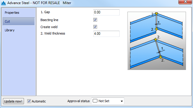

Miter cut Properties - Cut tab
On this tab of the properties dialog box, you can set the clearance between the beams.
Gap
Defines the construction gab between the beams.
Bisecting line
When selected, the intersection of the beams is created at the bisecting line.
Create weld
Creates a weld between the two beams.
2. Weld thickness
Defines the weld thickness.
