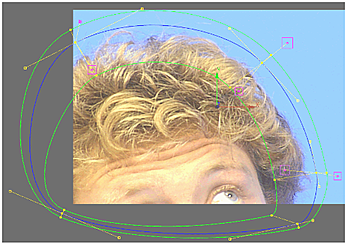

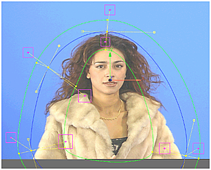

To assign pickers to selected vertices:
  1. From the Edge Softness box, select Tracer.
    The Tracer menu appears, and two softness borders (the green lines) are added to the mask.
    (a) Edge Softness box
  2. Select the vertices to which you want to apply pickers. See Selecting Vertices and Tangents.
  3. Enable Pickers.
    Note: When one or more pickers are enabled, mask characteristics are automatically set to Outside disabled and a Colour value of 0 so that the mask will be white inside and black outside. Do not set the Outside button unless you want to reverse the effect.
    A pair of pickers is provided for each selected vertex.
    (a) Softness borders (b) Picker
    • On vertices without pickers, the softness borders delineate the area where a softness gradient is applied.
    • On vertices with pickers, the softness borders delineate the area to which softness is applied according to the picker values.

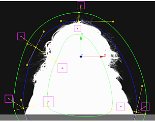

  2. For each pair of pickers, one requires a sample of the area outside the mask, while the other requires a sample of the mask interior.
    Place one picker outside the subject to sample values you do not want to include in the matte (for example, a blue screen). Place the other picker within the subject for a colour value sample of an area you do want included in the matte. Try to select areas where the colour values do not change too much throughout the clip.

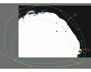

  3. Click Matte or Result (Matte will provide a clearer view) to see your progress.
  4. Scale the pickers by doing one of the following:
    • Select Scale edit mode, click within the picker, and drag to the left to reduce the size or to the right to increase the size.
    • Select the picker and then drag the cursor over the Sample Size field.
  5. Move the pickers around and enlarge or reduce them to interactively see how you can obtain the best results. This will require toggling between the Front and Matte views.
    The following figure illustrates the Matte view result of the pickers placed in the previous figures.
