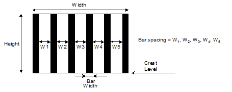

Crest
Crest Level is the level above datum of the base of the screen.

Width
The total width of the screen, including bars and bar spaces.

Height
The total height of the screen.

Bar width
The thickness of the bars making up the screen.

Bar spacing
The width of the clear gap between the bars. This is NOT the distance between the centre of the bars.
